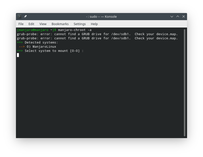

Re: WIederkehrender Fehler beim booten
Hallo gosia,
Okay ich habe es gemacht, nur leider kommt direkt eine Fehlermeldung:
- Screenshot_20210107_214631.png (36.37 KiB) 5137 mal betrachtet

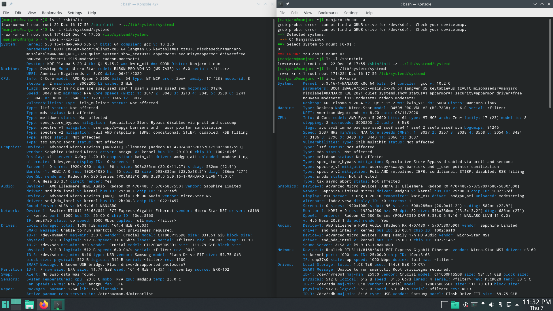

Ahh scheint wohl doch kein Fehler zu sein, die Befehle funktionieren nämlich trozdem:
[manjaro@manjaro ~]$ manjaro-chroot -a
grub-probe: error: cannot find a GRUB drive for /dev/sdb1. Check your device.map.
==> Detected systems:
--> 0) ManjaroLinux
==> Select system to mount [0-0] :
ls -l /sbin/init
/usr/lib/manjaro-tools/util-mount.sh: line 65: ls -l /sbin/init: division by 0 (error token is "sbin/init")
chroot: failed to run command '/bin/bash': No such file or directory
[manjaro@manjaro ~]$ ls -l /lib/systemd/systemd
-rwxr-xr-x 1 root root 1714224 Dec 16 17:55 /lib/systemd/systemd
[manjaro@manjaro ~]$ inxi -Fxxxrza
Kernel: 5.9.16-1-MANJARO x86_64 bits: 64 compiler: gcc v: 10.2.0
parameters: BOOT_IMAGE=/boot/vmlinuz-x86_64 lang=en_US keytable=us tz=UTC
misobasedir=manjaro misolabel=MANJARO_KDE_2021 quiet systemd.show_status=1
apparmor=1 security=apparmor driver=free nouveau.modeset=1 i915.modeset=1
radeon.modeset=1
Desktop: KDE Plasma 5.20.4 tk: Qt 5.15.2 wm: kwin_x11 dm: SDDM
Distro: Manjaro Linux
Type: Desktop Mobo: Micro-Star model: B450M PRO-VDH V2 (MS-7A38) v: 6.0
serial: <filter> UEFI: American Megatrends v: 8.C0 date: 06/11/2020
CPU:
Info: 6-Core model: AMD Ryzen 5 2600 bits: 64 type: MT MCP arch: Zen+
family: 17 (23) model-id: 8 stepping: 2 microcode: 800820D L2 cache: 3 MiB
flags: avx avx2 lm nx pae sse sse2 sse3 sse4_1 sse4_2 sse4a ssse3 svm
bogomips: 91247
Speed: 3269 MHz min/max: N/A Core speeds (MHz): 1: 3269 2: 3091 3: 3345
4: 3054 5: 3631 6: 3033 7: 3799 8: 3780 9: 3793 10: 3360 11: 3793 12: 3339
Vulnerabilities: Type: itlb_multihit status: Not affected
Type: l1tf status: Not affected
Type: mds status: Not affected
Type: meltdown status: Not affected
Type: spec_store_bypass
mitigation: Speculative Store Bypass disabled via prctl and seccomp
Type: spectre_v1
mitigation: usercopy/swapgs barriers and __user pointer sanitization
Type: spectre_v2 mitigation: Full AMD retpoline, IBPB: conditional, STIBP:
disabled, RSB filling
Type: srbds status: Not affected
Type: tsx_async_abort status: Not affected
Device-1: AMD Ellesmere [Radeon RX 470/480/570/570X/580/580X/590]
vendor: Sapphire Limited Nitro+ driver: amdgpu v: kernel bus ID: 29:00.0
chip ID: 1002:67df
Display: x11 server: X.Org 1.20.10 compositor: kwin_x11 driver: amdgpu,ati
unloaded: modesetting alternate: fbdev,vesa display ID: :0 screens: 1
Screen-1: 0 s-res: 1920x1080 s-dpi: 96 s-size: 508x285mm (20.0x11.2")
s-diag: 582mm (22.9")
Monitor-1: HDMI-A-0 res: 1920x1080 hz: 75 dpi: 82
size: 598x336mm (23.5x13.2") diag: 686mm (27")
OpenGL: renderer: Radeon RX 580 Series (POLARIS10 DRM 3.39.0 5.9.16-1-MANJARO
LLVM 11.0.0)
v: 4.6 Mesa 20.3.1 direct render: Yes
Audio:
Device-1: AMD Ellesmere HDMI Audio [Radeon RX 470/480 / 570/580/590]
vendor: Sapphire Limited driver: snd_hda_intel v: kernel bus ID: 29:00.1
chip ID: 1002:aaf0
Device-2: AMD Family 17h HD Audio vendor: Micro-Star MSI
driver: snd_hda_intel v: kernel bus ID: 2b:00.3 chip ID: 1022:1457
Sound Server: ALSA v: k5.9.16-1-MANJARO
Network:
Device-1: Realtek RTL8111/8168/8411 PCI Express Gigabit Ethernet
vendor: Micro-Star MSI driver: r8169 v: kernel port: f000 bus ID: 25:00.0
chip ID: 10ec:8168
IF: enp37s0 state: up speed: 1000 Mbps duplex: full mac: <filter>
Drives:
Local Storage: total: 1.08 TiB used: 210.7 MiB (0.0%)
SMART Message: Unable to run smartctl. Root privileges required.
ID-1: /dev/nvme0n1 maj-min: 259:0 vendor: Crucial model: CT1000P1SSD8
size: 931.51 GiB block size: physical: 512 B logical: 512 B speed: 31.6 Gb/s
lanes: 4 serial: <filter> rev: P3CR020 temp: 32.9 C
ID-2: /dev/sda maj-min: 8:0 vendor: Crucial model: CT120BX500SSD1
size: 111.79 GiB block size: physical: 512 B logical: 512 B speed: 6.0 Gb/s
serial: <filter> rev: R013
ID-3: /dev/sdb maj-min: 8:16 type: USB vendor: Samsung model: Flash Drive FIT
size: 59.75 GiB block size: physical: 512 B logical: 512 B serial: <filter>
rev: 1100
SMART Message: Unknown USB bridge. Flash drive/Unsupported enclosure?
Partition:
ID-1: / raw size: N/A size: 11.74 GiB used: 210.7 MiB (1.8%) fs: overlay
source: ERR-102
Swap:
Alert: No Swap data was found.
Sensors:
System Temperatures: cpu: 30.0 C mobo: N/A gpu: amdgpu temp: 27.0 C
Fan Speeds (RPM): N/A gpu: amdgpu fan: 811
Repos:
Packages: pacman: 1264 lib: 375 flatpak: 0
Active pacman repo servers in: /etc/pacman.d/mirrorlist
1: https://mirror.tuchola-dc.pl/manjaro/stable/$repo/$arch
--> 0) ManjaroLinux
0
==> ERROR: You can't mount 0!
[manjaro@manjaro ~]$ ls -l /sbin/init
lrwxrwxrwx 1 root root 22 Dec 16 17:55 /sbin/init -> ../lib/systemd/systemd

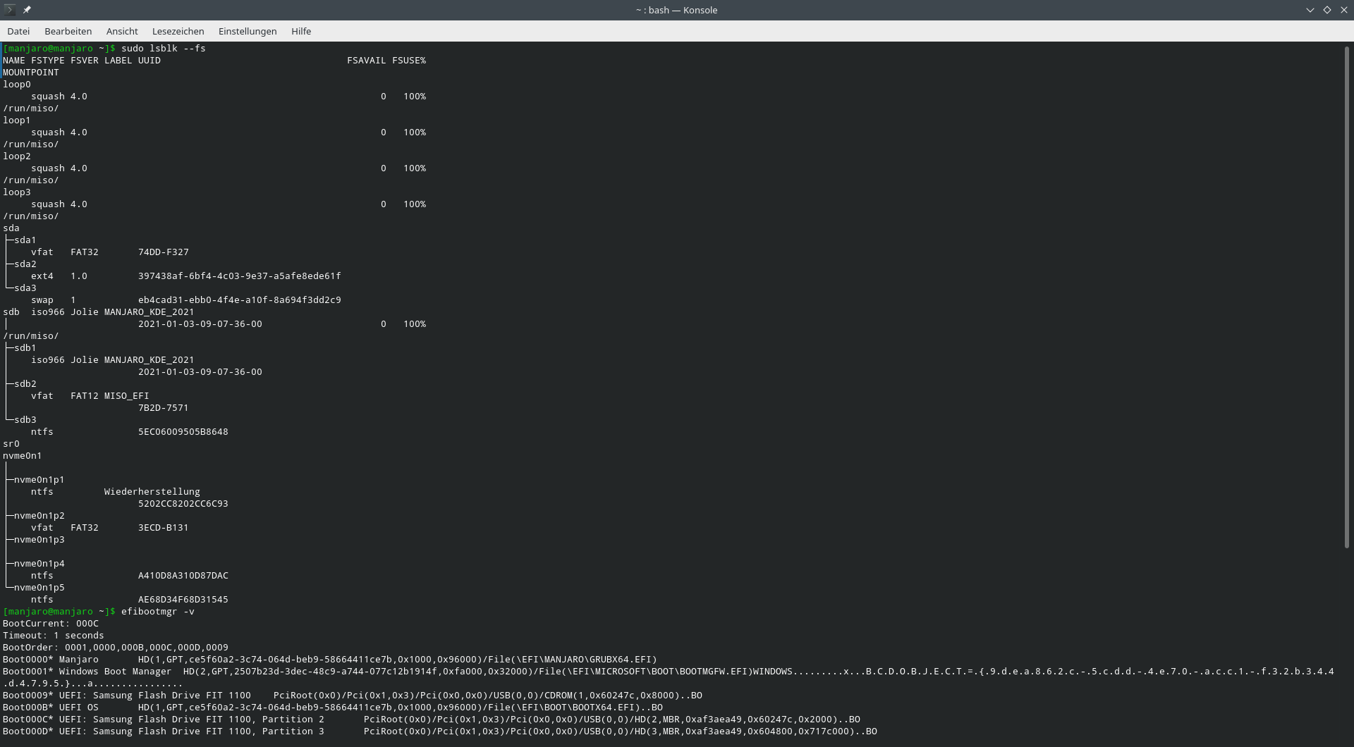

- Screenshot_20210107_233215.png (493.25 KiB) 5110 mal betrachtet
- Beiträge: 2506
Hallo DeeBee,
das wird schwierig, weil es wohl irgendwie mit UEFI zusammenhängt und da habe ich keine Ahnung. Aber trotzdem, boote nochmal vom Live-Medium und poste die Ausgabe von
ein vorheriges manjaro-chroot ist da nicht notwendig.
Außerdem, ist in deinem BIOS UEFI an? Wenn ja, hast Du Manjaro dann auch im UEFI-Mode installiert?
https://wiki.manjaro.org/index.php?titl ... tall_Guide
sudo lsblk --fs
efibootmgr -v
- Beiträge: 54
- Registriert: Mittwoch 6. Januar 2021, 20:22
- CPU: AMD Rzyen 5 2600
- GPU: Amd Rx 580 Sapphire Nitro+
- Kernel: 5.9.16-1
- GPU Treiber: Amdgpu
Hallo gosia,
UEFI? War das nich das mit grafischer Oberfläche und Maus-unterstützung? Kann man das überhaupt aus machen? Ich erinnere mich, dass man für Windows die Auswahl zwischen UEFI und CSM hatte, aber für manjaro konnte ich eine solche option nicht finden. Ich gehe jetzt einfach mal davon aus, dass es an ist, aber schaue gleich nochmal nach ob ich eine solche option finden kann. Also hier sind erstmal die Ausgeben:
Viele Grüße DeeBee
Viele Grüße DeeBee
- Screenshot_20210108_163203.png (127.87 KiB) 5045 mal betrachtet
